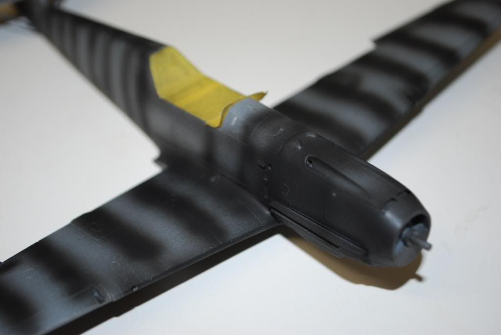

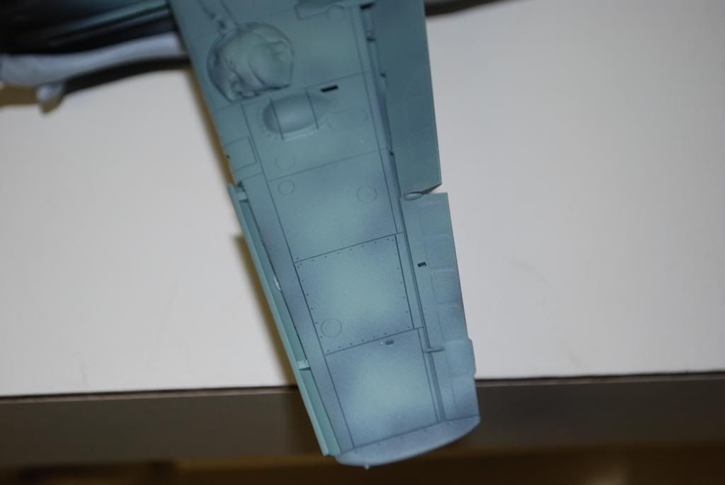

I always put a panel line paint down in order to assist the blending, particularly on lighter colours
I also made sure the nose and rudder sections were fiull black, to act as an undercoat for the yellow

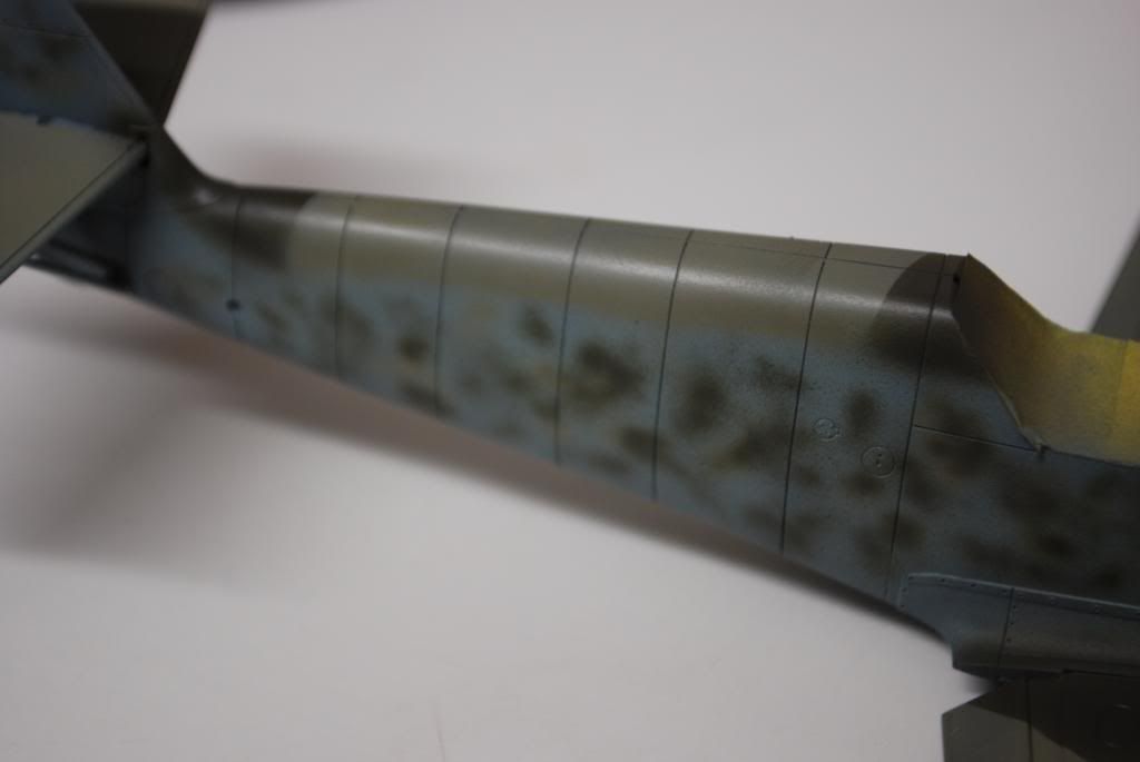

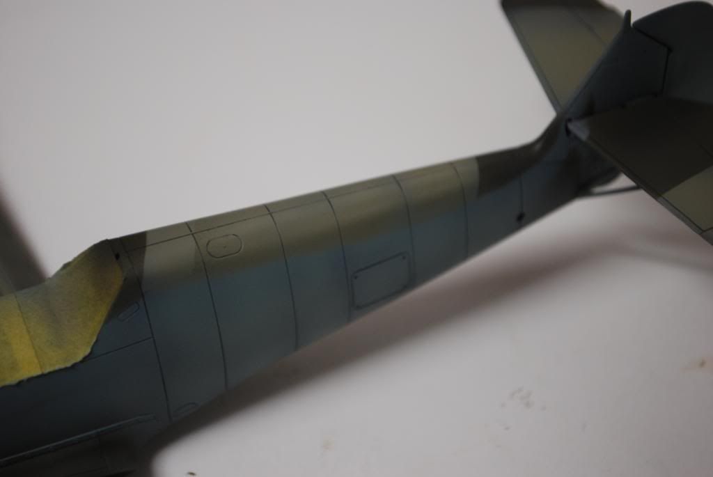

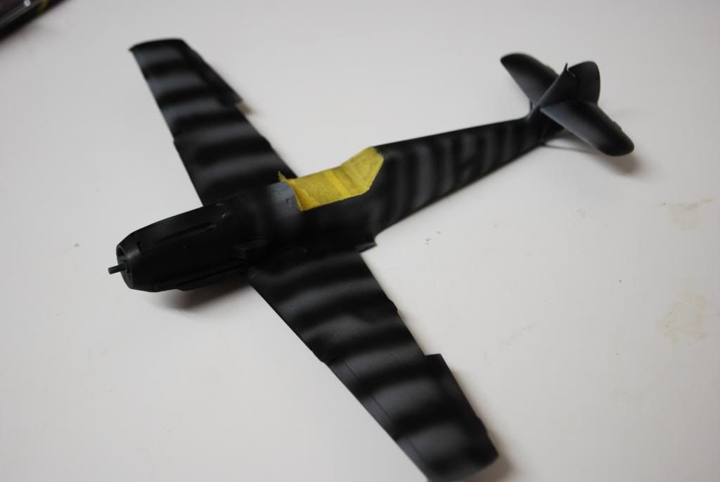

Next step was the fuselage line. Masked up with blu tac, the idea is to get a soft edge to them further blend in with the same paint used for mottling

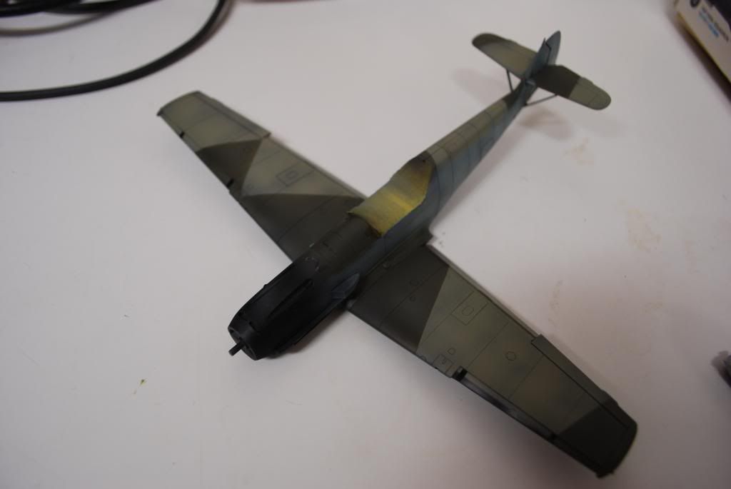

Paint applied to the top, you see the soft edge and also the hard lines between the two paint colours on the top, that was also applied on the wing surfaces

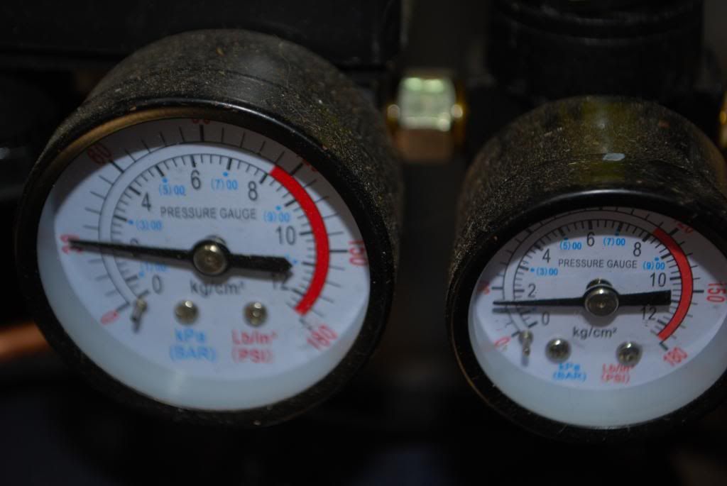

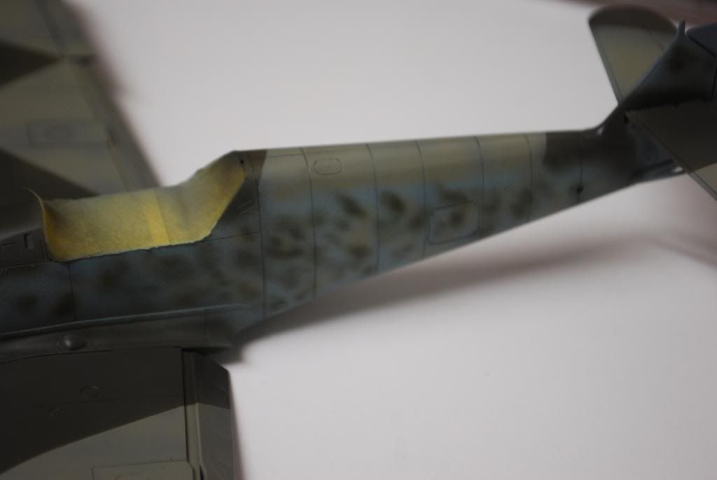

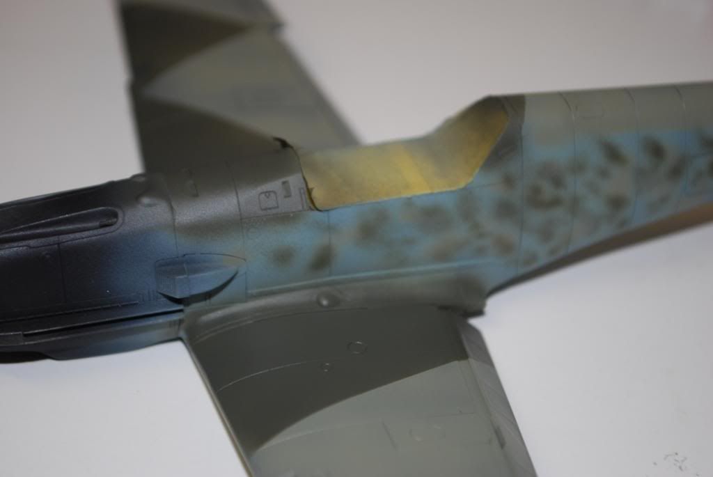

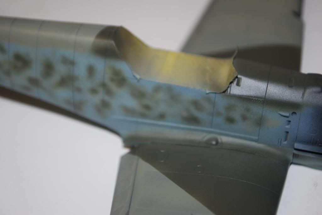

Mottling is on. Keep the paint THIN and the air pressure LOW, that allows great detail to be done with little overspray. The only paints I use are Gunze thinned with lacquer thinners, they dry quick and spray really nicely through my AZTEC airbrush using the fine nozzle (the only nozzle I ever use in the airbrush). You can also see how I have further softened the camo line running along the top of the fuselage with the same thinned mottling paint

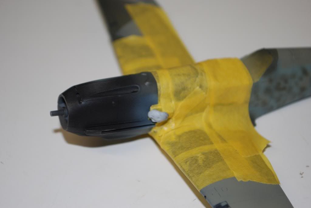

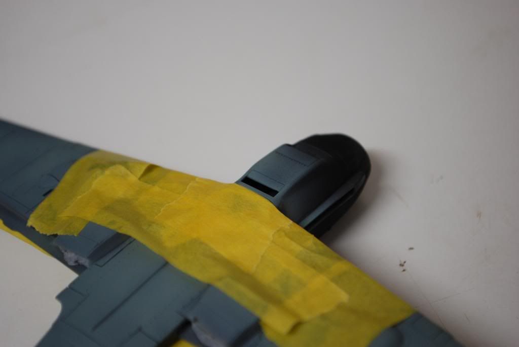

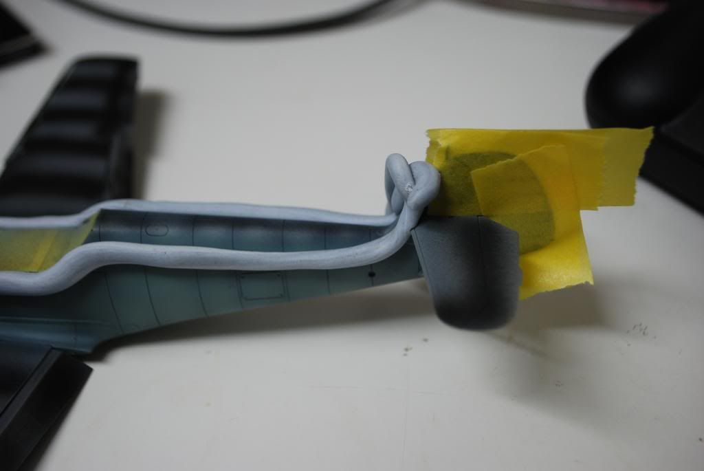

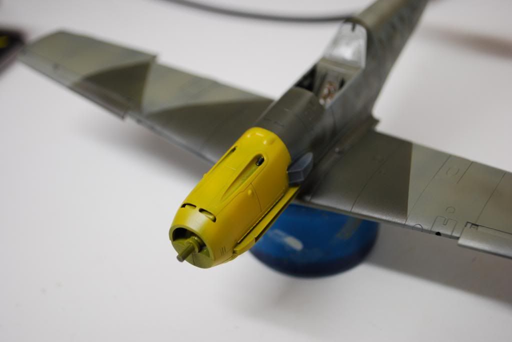

Masked up for the yellow nose, plenty of tape required

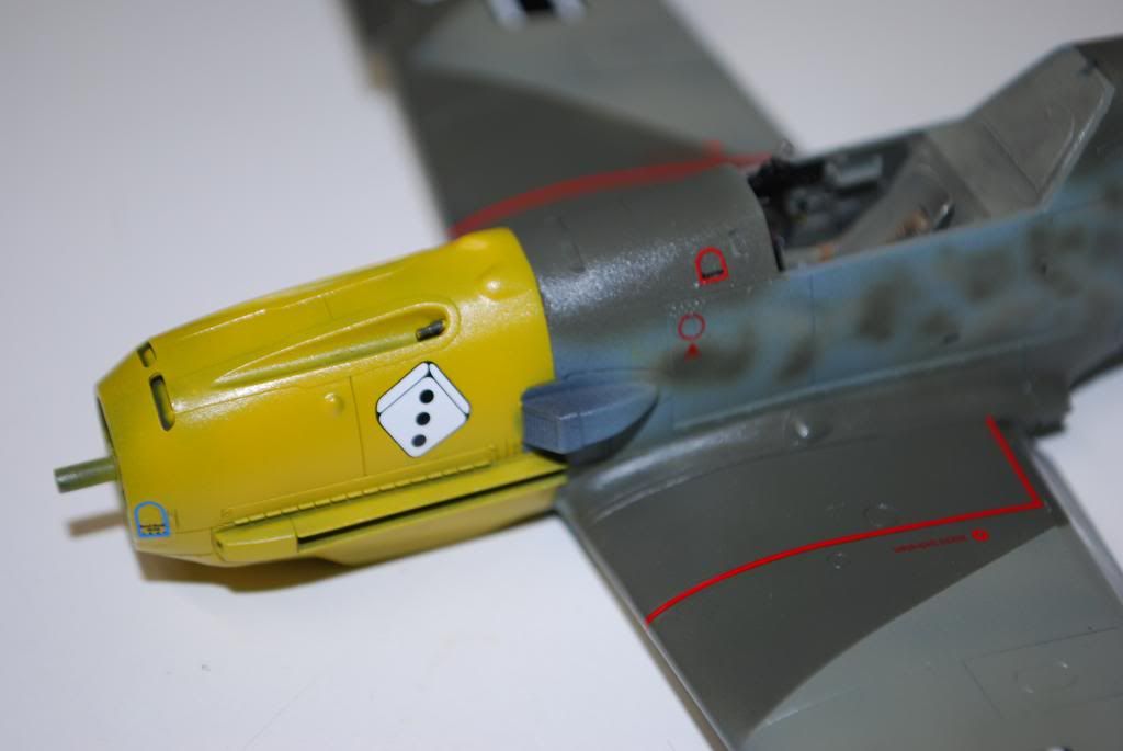

The yellow on with some mottling further emphasised on the fwd fuselage
The nose. I tend to only manage to succeed with yellow in the AZTEC using high pressure and moderately thinned paint
Decals

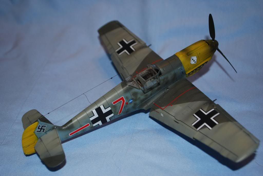

The finished product
Relatively easy with practice and patience. There are plenty of other articles out there so be sure to have a look at them. And happy to answer any queries here if people wish to ask.
